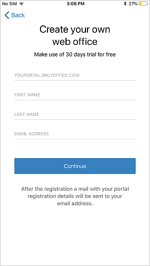

When you launch the Projects app for the first time, the Add new account panel opens. To sign in to your portal:
  1. Enter your existing portal address (https://portalname.onlyoffice.com) and tap the Next button.
    Start screen
  2. Enter your email address and password you use to access your account.
  3. Tap the Sign in button.
